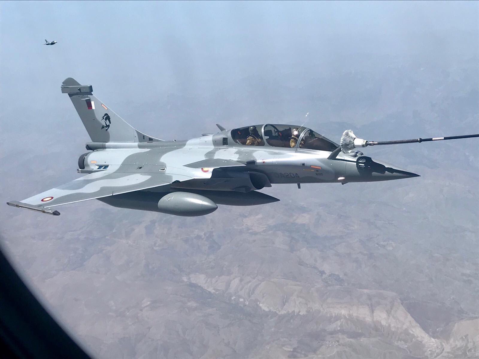

Rafale (Qatar Emiri Air Force)
Başlatan SKYWOLF, 07 Ocak 2020, 00:25:50
Dassault Aviation
Rafale
