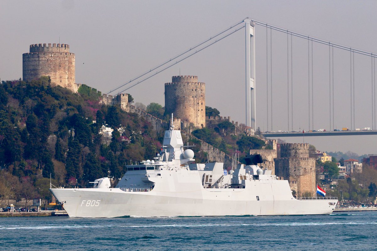

De Zeven Provincien Sınıfı Fırkateynler (De Zeven Provincien Class Frigates)
Bu Holladan gemileri SACHSEN SINIFI FIRKATEYNLERe çok benziyorlar. :)
F802    De Zeven Provinciën
F803    Tromp
F804    De Ruyter
F805    Evertsen
Operators:     Royal Netherlands Navy
Preceded by:    Tromp class frigate
Cost:    €600 million ($816 million)
In commission:    April 26, 2002
Completed:    4
Active:    4
General characteristics
Type:    Air-defense and command frigate
Displacement:    6,050 tonnes (full load)
Length:    144.24 m (473.228 ft)
Beam:    18.80 m (61.679 ft)
Draught:    5.18 m (16.9948 ft)
Propulsion:    2 propeller shafts, controllable pitch propellers
2 Wärtsilä 16V6ST diesel engines, 8.4 MW each
2 Rolls Royce Spey SM1C gas turbines, 18.5 MW each
4 GEC Alsthom Paxman diesel-generators, 1650 kW each
Speed:    29kn
Range:    4000+ nmi at 18 kn
Complement:    202 + 30
Sensors and
processing systems:
1 Thales Nederland SMART-L long-range air and surface surveillance radar
1 Thales Nederland APAR air and surface search, tracking and guidance radar (I band)
1 DECCA NAV navigation radar
1 Thales Nederland Scout (Low Probability of Intercept)surface search/navigation radar
1 Thales Nederland Sirius IRST long-range infrared surveillance and tracking system
1 Thales Nederland Mirador optical surveillance and tracking system
1 Atlas Elektronik DSQS-24C hull-mounted sonar, medium frequency
1 MK XII IFF system
Electronic warfare
and decoys:    1 Thomson Racal (now Thales) Sabre ECM suite
4 Sippican Hycor SRBOC MK36 launcher
1 AN/SLQ-25 Nixie torpedo decoy
Armament:    5×8 Mk41 vertical launch system with 8 cells each
Standard armament: 8×4 Evolved Sea Sparrow Missile and 32 SM-2 IIIA surface-to-air missiles
Another 8 cell MK41 VLS can be added
2 Goalkeeper CIWS guns
2 quadruple Harpoon anti-ship missile launchers
1 Oto Melara 127 mm/54 dual-purpose gun
2 Oerlikon Contraves 20 mm machine guns
2 twin MK32 Mod 9 torpedo launchers with Raytheon MK46 Mod 5 torpedoes
Aviation facilities:    Hangar and flight deck for 1 AgustaWestland Lynx or NH-90 helicopter
