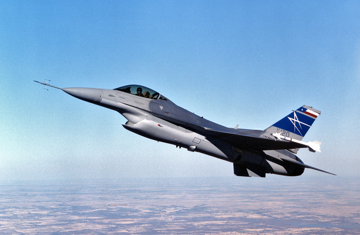

1996 yılında F-35 projesinin süpersonik hava alıkları bir F-16 block 30 uçağı üzerinde test edildi.Maksimum 2 mach hıza ulaşılan testlerde yüksek hücum açılarında testler yapıldı ve hava alıklarının mevcut hava alıklarından daha yüksek performans gösterdiği tst pilotları tarafından doğrulandı.
JSF Diverterless Supersonic Inlet
By Eric Hehs Posted 15 July 2000 TAGS: F-35 Lightning IIFlight TestF-16 Fighting Falcon
left

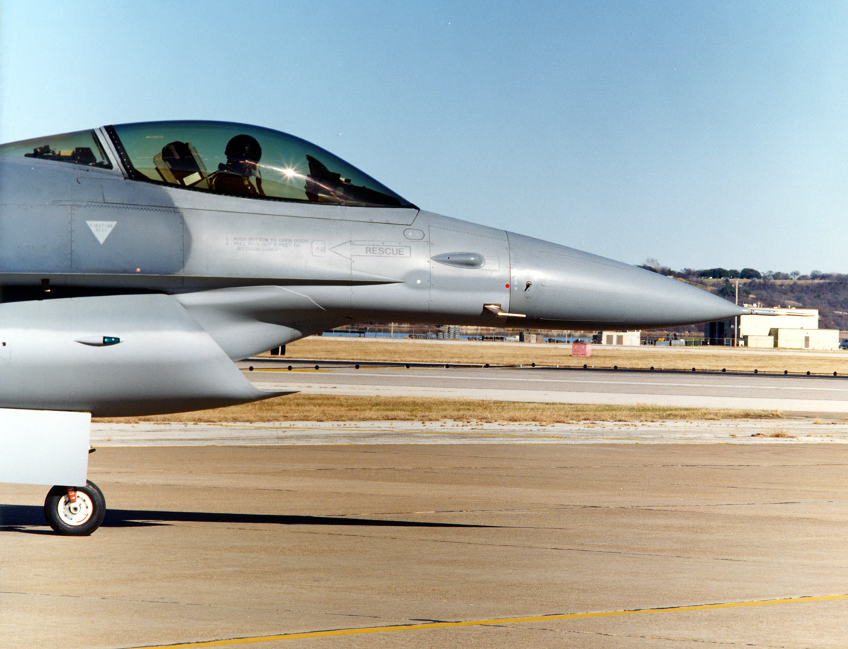

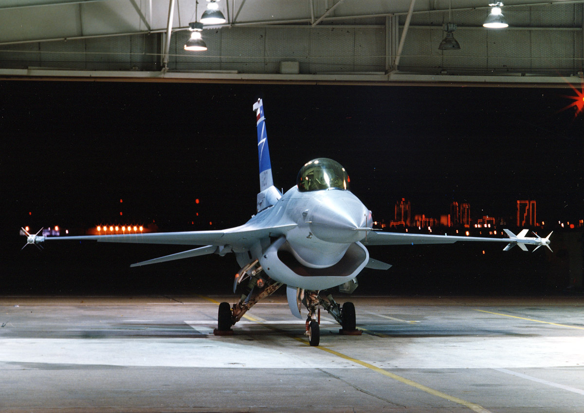

Sideview of an F-16 modified with diverterless supersonic inlet, or DSI, developed for the Joint Strike Fighter -- now the F-35 Lightning II -- program. At high aircraft speeds through supersonic, the bump in the inlet works with the forward-swept inlet cowl to redirect unwanted boundary layer airflow away from the inlet, essentially doing the job of heavier, more complex, and more costly diverters used by current fighters. The flight test program consisted of twelve flights flown in nine days in December 1996.F-16 modified with diverterless supersonic inlet, or DSI, developed for the Joint Strike Fighter -- now the F-35 Lightning II -- program. At high aircraft speeds through supersonic, the bump in the inlet works with the forward-swept inlet cowl to redirect unwanted boundary layer airflow away from the inlet, essentially doing the job of heavier, more complex, and more costly diverters used by current fighters. The flight test program consisted of twelve flights flown in nine days in December 1996.F-16 modified with diverterless supersonic inlet, or DSI, developed for the Joint Strike Fighter -- now the F-35 Lightning II -- program. At high aircraft speeds through supersonic, the bump in the inlet works with the forward-swept inlet cowl to redirect unwanted boundary layer airflow away from the inlet, essentially doing the job of heavier, more complex, and more costly diverters used by current fighters. The flight test program consisted of twelve flights flown in nine days in December 1996.F-16 modified with diverterless supersonic inlet, or DSI, developed for the Joint Strike Fighter program. At high aircraft speeds through supersonic, the bump in the inlet works with the forward-swept inlet cowl to redirect unwanted boundary layer airflow away from the inlet, essentially doing the job of heavier, more complex, and more costly diverters used by current fighters. The flight test program consisted of twelve flights flown in nine days in December 1996.
The unassuming fuselage bump at each inlet on the Lockheed Martin Joint Strike Fighter performs miracles that only aeronautical engineers can fully appreciate. At high aircraft speeds through supersonic, the bumps work with forward-swept inlet cowls to redirect unwanted boundary layer airflow away from the inlets, essentially doing the job of heavier, more complex, and more costly approaches used by current fighters.
DSI Flight Tests
The overall inlet design, called a diverterless supersonic inlet or DSI, moved from concept to reality when it was installed and flown on a Block 30 F-16 in a highly successful demonstration program. The flight test program consisted of twelve flights flown in nine days in December 1996. The first flight on 11 December addressed initial envelope clearance and functional checks. Subsequent flights addressed performance characteristics of the unique inlet design in both level and maneuvering flight. Rapid throttle transients during these flights confirmed the compatibility between the inlet and engine.
The flight tests covered the entire F-16 flight envelope and achieved a maximum speed of Mach 2.0. The modified aircraft demonstrated flying qualities similar to a normal production F-16 at all angles of attack and at all angles of sideslip. Lockheed Martin test pilots performed two inflight engine restarts and 164 successful afterburner lights, with no failures. Fifty-two afterburner lights were performed during hard maneuvers. No engine stalls or anomalies occurred during the test flights.
The new inlet showed slightly better subsonic specific excess power than a production inlet and that verified the overall system benefits of eliminating the diverter. Test pilots remarked that military power settings and thrust characteristics were very similar to standard production F-16 aircraft with the same General Electric F110-GE-129 engine. Considering the overall goal of the flight test program was to demonstrate the viability of this advanced inlet technology, the results were excellent.
